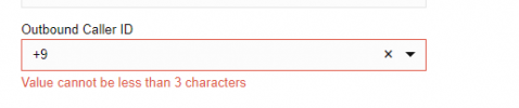

Since V20 Caller ID field in the user settings accepts a minimum of 3 symbols!
I need it just like before, only single digits like 9 for the fax. Is there an option to change or avoid this limitation?
You mean this, right?
I have multiple outgoing DIDs with different numbers. In this case, I am using Caller ID to be added to the base number of the DID by the outbound rule. For the fax, it will be +xxxxxxxxx9 for the DID1 and +yyyyyyyyy9 for the DID2.
Yes I meant this mask

well that +9 is not a caller id...
However you may try the following, enter the extension number as caller id, then in your sip trunk --- options ---- Reformat Outgoing Caller ID you can set a pattern like
Source: (...) or (100)
Replace: your DID\1
See more info here
Another alternative is using the outbound rules and set the caller id from there.
Yes, I have done it like this till V18 and it was fine. Now with V20 mask is not allow less than 3 symbols but I have only two XX numbers for the extension and sometimes even one in the fax case. Anyway, I made now next work around 009 and stripping 00 by the outgoing rule for the FAX and 099 striping 0 for the rest :)
