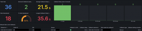

Hello, thank you for your explanation and that a good approach to restrict to queue agents only.
But it's not working for me, here is the step I did :
- Calling a queue with one agent
- Call ends after 20sec of wait / call abandonned
- The one agent calling back and i let the call last ~30sec
- Force the push of the CDR into database
- Check my grafana
The manual callback doesn't show, I did the same step but with callback enable on queue and it works.
I'm using posgresql database, maybe I did something wrong.

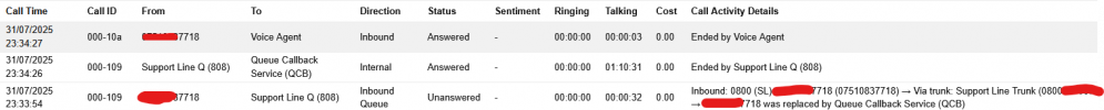

Question
When you make the call (when you process the missed call), is the call egressing from the same trunk it came in?
Can you send your call logs.. Check from which trunk the call came in and see if it went out from the same one. We think that this could be the issue you are experiencing.

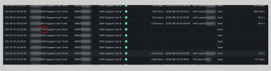

I think I have some discrepancies too.
If I look at call ending 718

Yeah, i'm playing with our sandbox 3CX with multiple trunks and i wasn't recalling with the same trunk as you expect.
Try it with the same trunk and worked instantly :)
