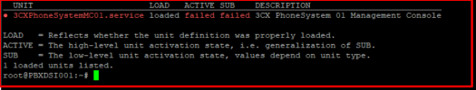

I'll share the printout

try
Bash:
sudo systemctl restart 3CXPhoneSystemMC01
Reactions: Albano Belchior
