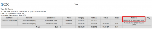

Ok if you roughly remember the time, then generate a report to see what really happened to your call:
You should expect to find that call, and the reason explained. For example:
we have the following report:
2/18/2022 11:59:24 AMUSER 1 (022)USER 2 (049)unanswered00:00:1900:00:0000:00:190.00Failed Canceled
