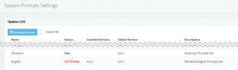

One more thing to check:
  1. In the 3CX Management Console got to Settings --> System Prompts
  2. Here, on the section "Updates" at the top, expand it and check if there are any "Out of Date" prompts.
  3. If you do, check them and press "Download Selected"
  4. Go to Dashboard --> Services, selected everything and press "Restart".
