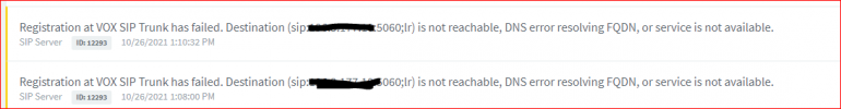

This the logs where its got the problem
10/25/2021 6:53:15 PM - [CM504005]: Registration failed for: Lc:10000(@vox SIP Trunk[<sip:[email protected]:5090/UDP>]); Cause: Cause: 408 Request Timeout/REGISTER from local

fire all seems fine the logs is popping up with 408 Request Timeout/REGISTER from local

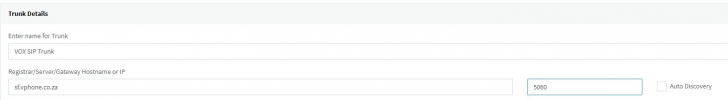

I think what's at fault here is the SIP Port you're using for the SIP Provider. Try switching it to 5060:
i have set it on auto ports ect and try 5060 i am using AWS services to host 3cx when i spoke to vox they said seems like its a thing form 3CX hmmm

Stick to port 5060 as per the template and contact Vox and ask them if they need to whitelist your public IP. If i remember correctly from the testing we did that was needed. If you already gave them an IP make sure you still have the same IP or the requests are not going out from a different one.
