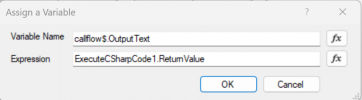

In my CFD app I'm trying to write a custom c# script Base64 converter in order to convert wav output from Record component (Record1.AudioId) to a base64 string (put to variable OutputText) that could be later embedded in JSON request. What is the correct approach here?

The AudioId is the file path. So you will need to read the file contents, encode it as you need, and return the encoded text.

3.assigning the returned value to OutputText using assign variable component (should I do it inside the script?)

Now the error seems to be resolved
