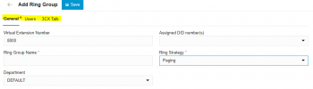

It does not appear to be possible to add an extension to a multicast paging group where you suggest. For comparison, here's a screenshot when creating a new ring group with ring strategy "Paging":

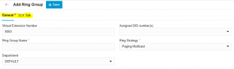

Here's a screenshot when using ring strategy "Paging Multicast", which is what we require:
As you can see, "Users" is missing here. So while we can create a multicast paging group, the 3CX GUI no longer appears to have a way to assign either users/extensions or phones to it. Unless I'm missing something, this still appears to be a loss of functionality from v18. Please advise.
