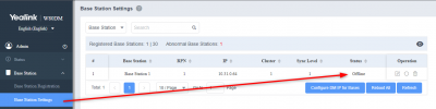

The W80DM is accompanied by one or more W80B bases that act as the radio antenna (the DM does not transmit any radio signals AFAIK).
You might want to check whether the W80B disconnects during the event, by logging into the DM and checking to see whether the Base(s) is still synchronized
