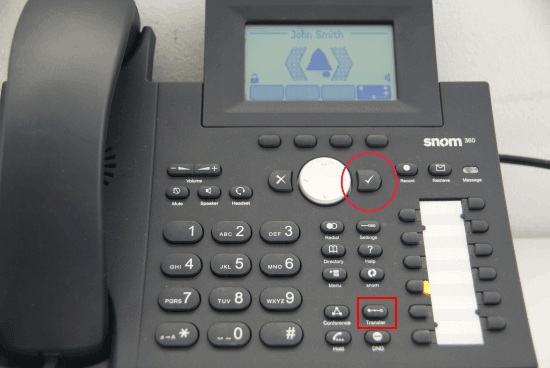

Blind Transfer Method
  • Press “OK” (check mark) to answer an incoming call.
Snom - Blind Transfer
  • Press the “Transfer” button to start the blind transfer procedure. Dial the extension number of the person you would like to transfer the call to. Press “OK“.
  • The call has been transferred to the specified extension.

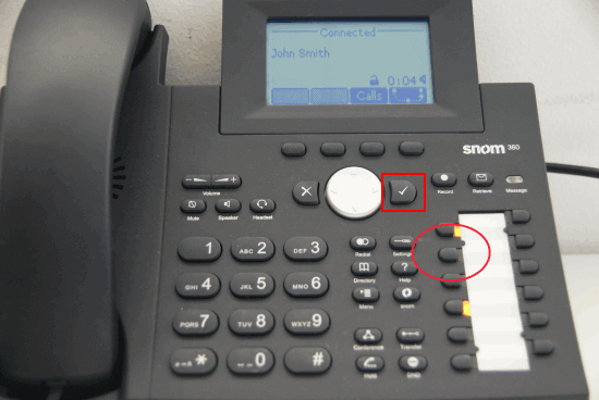

Attended Transfer Method
Snom 360 - Attended Transfer
  • While on call, press “Line 2” to initiate a new call. This will automatically put the caller on “Line 1” on hold.
  • Dial the extension number of the person you would like to transfer the call. Press “OK".
  • The transfer recipient answers and accepts to take the call.
  • Press the “Transfer” button followed by “OK".
  • The call from Line 1 and Line 2 are now merged.
