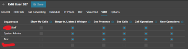

What are the ways a user could blind transfer from PWA without picking the call up?
They dont have this extension as a BLF.
441 was logged in to this queue at the time and 624 is not in this queue.
You could blind transfer from the panel if you have the rights to do so.
Reactions: NikosT_3CX
How? I've tried to simulate.
Im only able to blind transfer a call once the call is in progress
Did you try a queue call, or a normal call?
Its a queue call and i've got rights and queue manager.
When I right click it:
When I drag and drop:
When im on the call I can do what I like
OK, note to self... when performing tests make sure you're not the only one in the queue..
I dont get the option to "divert" calls when im being polled but I can do it on polls to other agents.
I can replicate the problem now - though customer tells me "i didnt do anything" but the evidence is there.. SMH.
Anyway.. on a side note.. I just learnt that if you hold down ALT when dragging and dropping the call it toggles between blind and attended transfer.
