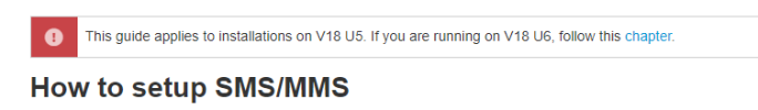

Inside the guide you quote there is a banner that says if you are using version 18 Update 6 then you need the new guide. Not sure if it pops out for you so here is the link for the new guide.
The option is gone, now all extensions are enabled by default if they are able to receive SMS they are able to send SMS. So if they have a DID assigned to them or they are part of a Queue that is assigned a DID then they can also send SMS. No need to enable additional options.
