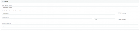

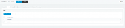

I have to ISDN E1 Interface on Cisco Router 2951, each E1 have a different phone number,, and i need to configure a 2 SIP trunk between router and 3CX system,, each phone number connected to a dedicated SIP trunk,, because each SIP trunk will be connected to different Call Center agent,,
I try to configure 2 SIP trunks but all calls were forward to the same trunk, because using the same IP and Port, so any advice to solve this issue?
