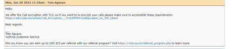

but this is what exactly they want me to do.???
https://wiki.voip.ms/article/Call_Encryption_-_TLS/SRTP#Configuration_on_SIP_Client
and as soon as i enable this getting error message
Did you read the entire article or read what @YiannisH_3CX posted? That setting turns on encrypted traffic on the voip.ms side of things. Then it says this:
That means you have to enable encryption on the 3CX side. As mentioned, 3CX has not tested this so you are better off leaving it off.
