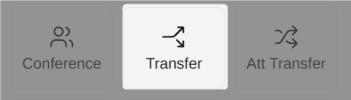

The client's remote control mode has a limited list of functions:
Here hold/unhold is not supported.
So you cannot return to the caller, only these are available during a call:
Otherwise a second call starts that is not linked to the original one.
If you want more flexibility use only the D735 physical phone buttons.

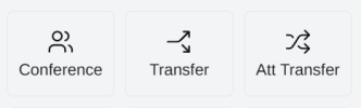

Unlike desk phones, for DECT devices we don’t support uaCSTA, the protocol we use to control desk phones remotely.
So instead the PBX simulates the functions for you, with a few limitations:
  • When you dial a number, your M900 rings first. Once you answer, the PBX connects you to the number you dialled.
  • When you end the call, the PBX disconnects your M900.
  • You can make a blind transfer.
  • Conference calls, hold/resume, and attended transfers aren’t available.
Only this will appear as active:
This gives you remote control of desk phones, plus some control of DECT and FXS devices too.
I hope this helps clarify what you can do with remote control and where the limitations are.
