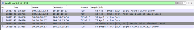

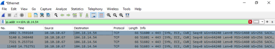

Yes, firewall policy was turned off, but still the same issue occurs. attached some screenshots of wireshark capture while accessing activate.3cx.com via browser and via the management console. On a separate note, the system was working flawlessly and issues came just after the update from version 18 update 4 to Update 5. On the portal, its listed that i'm still on update 4 but i've already migrated to update 5 on the 3cx on premise.
Are you doing any sort of SSL/Deep packet inspection (maybe listed as SSL bumping in some system)?
Unfortunately no. Nothing has been changed within our IT infrastructure.
If I browse to http://activate.3cx.com/ I (after a minute or so) get a CloudFlare message saying it couldn't connect with 3CX.com. I suspect that is because it isn't supposed to be browseable, but I do get a message. https://activate.3cx.com/ shows the blank page you show, but also note that is not a timeout it is a blank page being returned by the web server.
