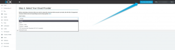

Have you stopped hosting 3CX on DigitalOcean cloud droplets?
I cant see it on the dropdown list
We've actually only recently added DigitalOcean to the 3CX self-hosted list of options, however, you will need to switch to our new customer/partner portal to get the new deployment wizard and hence DigitalOcean as an option.
Just click on the "Try new portal" button on the top right corner:
Remember to check out our guide too: https://www.3cx.com/docs/hosted-pbx-digitalocean/
