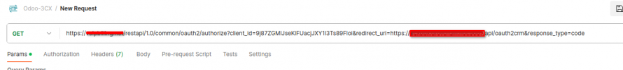

If I use this code in a browser I get a code , if I use the same in postman as a hard coded get I get a 404 and the same if I do it as a php curl statement. If I copy the get command shown below and paste it into a browser I get the code.1695331812763.png
I haven't been able to get any successful results in Postman, even authorize
The browser performs a GET request. And most probably 3CX will perform a POST request as that's the standard to get a refresh token in OAuth2. Maybe your CRM is implementing a different variant and you will need to adjust the requests accordingly...
