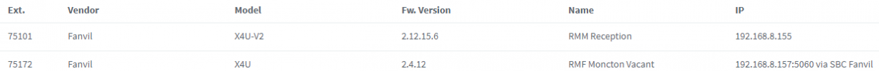

The X4U has FW: 2.4.12
The X4U-V2 has FW: 2.12.15.6
