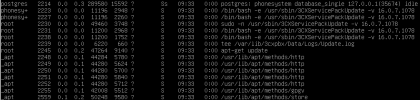

Greetings everybody,
we are trying to update our 3CX Phone-System from v16.06.655 to 16.0.7.1078 (Debian 9, Linux-VM running on HyperV).
When selecting the Update via Management-Interface:
- Logout from Management-Interface happens
- Update-Processes on the Linux-system are starting up
- it seems nothing is happening after that
Around 12-15 hours later there comes a Mail, stating "Update has failed" (contents of the "Update.log" as follows. Note: thats all there is, i did not cut anything out. "Holen" = "get" ;) )

Restarting the Linux-VM could not solve this Problem. Is there a special trick with this update, do we need to reinstall?
Any help is much appreciated!
