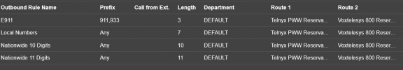

I'm also having issues with the call back. I have check my outbound rules tons of times but I can't get the system to connect to an outside number. The call back feature will only work for internal extensions.Screenshot 2026-03-14 151117.png
I have even reordered the outbound rules and gotten nothing. Any ideas would help we are about to enter our busy season and this feature needs to work.
I'm also having issues with the call back. I have check my outbound rules tons of times but I can't get the system to connect to an outside number. The call back feature will only work for internal extensions.View attachment 51227
May I suggest you start a new thread with more details on what your exact issue is, expected behaviour, what goes wrong, anything visible in log files that can help troubleshoot.
