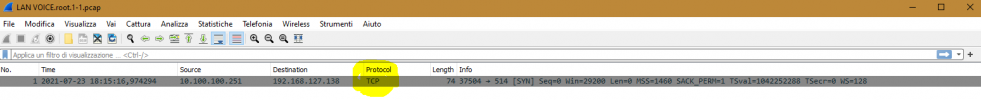

I see that the protocol is TCP
How can I change it to UDP?

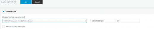

Here the configuration of 3CX:
