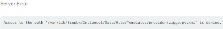

At this point, I am guessing it is a permissions issue. My auto-updates have been failing, so I tried to manually update and got an access denied as you can see in the pic below:
What should the permissions be on the folders and items 3cx needs access to? These are the current perms:
I am guessing the Add Phone issue I am seeing is probably the same. Probably trying to access a folder or file where the templates or something are stored...?

I had the genious idea of checking the other system and found that phonesystem user is chowned for all those files... Not srue why I didnt think of hecking there sooner. i will update to let you know if this is the issue.

So fixing the permissions fix the update issue, but the intial issue of not being able to add phones via the Add button remains.

I was thinking about this while doing other things and remembered I was supposed to run the initial config script with the phoneuser account. I believe the issue must be there. I will do a reinstall and see if that fixes it.

The ISO is essentially the same as the 3cx image in Azure. The issue was forgetting to run the initial configuration script with the phonesystem user. I just removed the old configs with /usr/sbin/3CXWizard --cleanup and then ran the intial configuration script with phonesystem user. Another caveat to note is that you need to chmod the cert files at 644 so that the phonesystem user can read them when running the initial config script.
