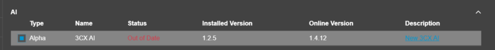

My system is using the AI version 1.4.12 with sp9, however note this is only for testing purposes since it is in Alpha version yet.
i am not on update 9 yet due to voiptools compatibility, however, i did update the latest AI update to 1.4.12.
The exact prompt you see will depend on what AI version you are one, and if you had made any customisations to it at any point in time.
At this time, going into update 9, call by extension number will not work 100% of the time even if the prompt permits it - as the agents get more functional this will of course improve.You could try entering the extension number in the AI routing description of that extension, so that the agent picks clues from that.
