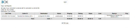

Hi @NonLinearly this is easy to replicate.
Please note that an abandoned call occurs when the call reaches the destionation if no answer or when the caller ends the call that was in your case.
The system will try to poll the available agents, but if the caller hangs up, this is an abandoned call. Those 49 seconds was the time that the system tried to poll the agents.
I replicated this on my system, for example called the queue, the system polled an agent then I ended the call
So I wait 12 seconds in the queue that is the talking time, as you may know a queue is an auto attended destination.

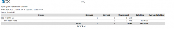

Then if you run the queue performance overview you get more details
You see Pedro Perez with 1 poll, and there is 1 unanswered call.
Hope it's clear enough for you.
