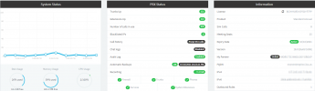

Here's my information:3cxPic.png

Hi @MorganX,
From what I can see in the screenshot of your Management Console, you are currently on V18 build 1379. As a first step, could you please upgrade your installation to the latest V18 build which is Alpha 5?
