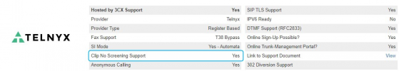

Telnyx does allow Clip no Screening so they should allow it:

Telnyx doesn't support 302 tho. I tried.
