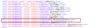

Hi All,
I’m encountering an issue with call forwarding to mobile numbers. Currently, when a call is forwarded, the caller ID displayed on the mobile shows the SIP trunk number instead of the original caller’s number.
This was working as expected on version 18, where the original caller ID would be preserved. I’m familiar with the relevant settings in v18, but in version 20, I’m unable to locate the same options or achieve the desired behavior. I’ve tried all available SIP trunk configuration options, but none seem to resolve the issue.
If anyone has experience with this in v20 or can provide guidance, your help would be greatly appreciated.
Best regards,

Hi Dimitris,
Thank you for your assistance.
To clarify, we are also the provider and are using our own SIP trunk. For reference, call forwarding via our SIP trunk is working correctly on version 18.
I followed your suggested steps (Admin > Voice & Chat > Edit your provider > Options > Caller ID Control), but unfortunately, the issue persists.
I also exported the configuration of the SIP trunk from the working system, imported and compared it with the current one— but with no success.
Could you please advise on any additional settings or areas I should investigate further?
Thank you
Rajan

This depends on the SIP Field you are expecting this information.
In most cases, you will have to change the FromUserPart to show "OriginatorCallerID"
In your case, which is the SIP Field you expect this information to be in?
Hi @DimitrisL_3CX
I have changed to ''OriginatorcallerId'' on both field,
Doesn't work.

There is no other option in the PBX for the OriginatorCallerID. You may start a packet capture and see if the PBX sends the correct information to your provider. If the correct information is sent from the PBX side, then I would suggest contacting your SIP Trunk provider to check this also with them.

Capture the SIP signaling traffic being sent to the trunk provider.
If the information is present, then your next question should be directed to your trunk provider. If the information is NOT present, then you have a configuration issue with your trunk template.
The issue is that the phonenumber of the original caller is added as a name, but the uri is not changed.
This is the INVITE coming from 3CX (phone numbers and ip addresses have been redacted for privacy reasons).
In this example, +32474654321 is the number of the original caller, +3257987654 is the number that is called, and +32474123456 is the number that the call is forwarded to.

Since the Diversion header contains the number that is doing the forwarding, this number should not be present in any other header.
@DidierDE number +3257987654 is in the Diversion Header because this is the originally dialler number.
Call a DID and this is what you will see there.
Now number +3257987654 is in the Remote Party ID User Part and the From User Part as this is what the template has.
You may change these settings on what you want and then try again.
Check here : https://www.3cx.com/docs/voip-provider-template-builder/
Solution
Changing the template did indeed do the trick. Thanks for your assistance!
