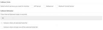

Also, what options have you set here and what failed on the Active server the last couple of times the failover failed:
Depending on the situation, the failover may not trigger based on these settings.

Here are the failover setting.I'm confuse to where you mention the active IP of the active server.
