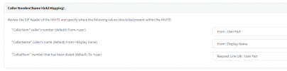

i'm trying to block a number on the blacklist. it shows up in call log as: First Last (4066723102)
i added the number to the blacklist as 4066723102
however, the call is still ringing through. My concern is that i have something set incorrectly on my SIP TRUNK inbounc parameters. Can you advise?

it's being presented as 10 digits. i tried wild card and no change. Per my previous question, could it have anything to do with my SIP Trunk Inbound Parameters? How do you have yours set?
My trunk is exactly the same, with no check mark in Call Source Identification.Try the wild card with just the last 4 digits *3102

it's not routed to any endpoint. the only inbound parameters i spoke of are on in the screenshot on my first entry on this thread. Set exactly the same as they are on another system with the same provider, sending the same amount of digits. it's just weird that it works on one system then not the other. I do feel like there is something i am missing; but I'm not sure, lol:) I may take your advise and open a support ticket.
