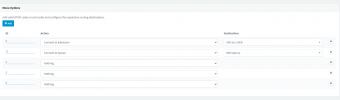

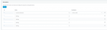

This is all-or-nothing im afraid and can be achieved by switching the VR from a standard IVR to a DTMF input IVR
Then settibsg the destination same as you have with the standard IVR to but you also have extra options you can chose for the DTMF inputs, so here is chose when 0 is presed to go to EXT 000
Then when 11 is dialed will go to a queue and so on
WIth DTMF IVRs there is no direct daling to reach any extension.
