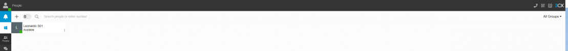

Hi i'm setting up bridges between 2 3cx installations,
I have a Master bridge on a already installed an used 3cx installation.
I have set up a slave bridge on our new 3cx .
I have configured the publish information, on both , but i can't see the extensions of the other pbx:
Can somebody help?
On the master bridge i can see the other side: 1650353558644.png
But on the slave not...
You will need to select the group you want to publish on your master side too and select who can receive information on the slave. Make sure you put in the correct URL including port number for the receive information server.
1650354131859.png1650354141305.pngi did it still seing only on the master side
Okay it worked now :D
