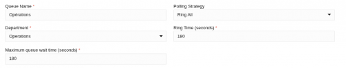

We have a queue with 20 agents. The queue is configured like this:
While the Maximum queue wait time is set to 180 seconds (3 minutes), we have sometimes callers who are stuck in the queue for more than 3 minutes (sometimes more than 5 minutes).

Yes, think of it this way.
The max wait time is the depth of a queue.
Example: There is a queue of people lining up. The maximum time you will wait in the queue before the "next action" is 180 seconds.
The ring time is the time it rings, and the time it will retry to ring an agent.
Example: There are 3 people serving customers. There are 10 people in the queue waiting to be served. Every 30 seconds it will look for any agents available and then put someone from the queue to an available agent.
If your Ring Time is 180, and your queue depth is 180, then it will not try to put someone from the queue back to the agent as there is no opportunity to re-poll an agent to check their availability.
I hope that clarifies it for you.
Best
Lance

Lance,
thanks for the detailed explanation. Actually it makes sense.
I will change the ring time.
I changed the Ring Time on the queue but still experiencing the same issue.

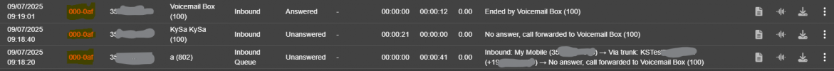

This is because the queue after it's expired is set to ring an Extension, not to a Voicemail directly. The extensions ringing time (before it is answered by the user or goes to the extension's voicemail) is counted in the Queue talk time, as during this period the queue is trying to make that extra call, and only sends the user over after that call is answered by the user or their voicemail.
Below is a call to a queue with a timeout of 20s, forwarding to an extension, with 20s timeout as well, before it goes to voicemail:
By following the call ID we can see the 21s Ringing on the extension is part of the queue's 41 Talking.
