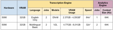

I assume i'm missing something here.
In the requirements it says "Nvidia 24GB RTX GPU".
However in the benchmarking table usage is under 8GB
Meaning technically speaking an 8GB GPU should work, am I looking at this right?
No you are not. The hardware requirements are written there clearly .
So VRAM Usage in the table above is not related to the size of the Model?
If not, what is it referring to?
We have tested with lower VRAM cards, below 24 it will not work with the speed+parallelism and reliability required for an Enterprise solution.
And yes, it will not just be the model size but also the audio that needs to be loaded etc. Without getting into details that can easily be found online, unless you are a tinkering hobbyist you need at least the minimum recommended spec.
That's not the case. I have a 1080 Ti 11GB sitting here wishing it could be used. It's not going to work for the following reasons.
The 3CX AI Engine runs several models in tandem to produce a result. We run approximately 4-5 models. The total minimum need of these models together is around 21GB which is why an L4 with 22.6 ish GB is barely the minimum but ones with 20GB are not a good pick.
Also if you notice the 64k context in the diagram, this implies that 64k context = 32GB of vRAM.
You can't use an 8GB, 16GB or 20GB card.
