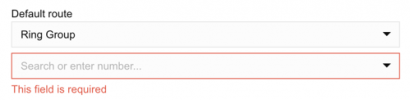

Hi @VinnieI
It sounds like on the Trunk you have the Default Route set to End Call
Set the Default route to Ring Group then select your Ring Group
You can also check where it's routing under Reports > Call Log
