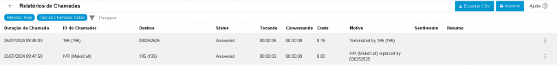

I'm using the 3CX Call Control API for use click2call (MakeCall) function.
When I send the request to the API the Call Control makes the system call the origin set, and when I answer the call on the set it starts a call the destination sent on the request.
In the same PBX I'm using the Call Journaling function. When the PBX sends the register of the call to the end point configured on the Call Journaling integration, this is send as an incoming call, what doesn't make sense, once the call is outbound, it was just started from a external request, but still being an outgoing call from the set.
In the call log we can see that the IVR makes the call to the origin set and when this set answer the call is initiated to the destination.
Is this a particularity of the PBX to register as incoming on the journaling the outgoing calls made through MakeCall?
Is there a way to change this?

The Call Journaling will show what really happened. In order for this to work as you need, you will need to change the invocation of the MakeCall method, and use the variant that receives the RegistrarRecord as first argument. You will need to get the RegistrarRecord for the extension from which you want to initiate the call, and then start the call from it. This way the user will not see the "MakeCall" caller ID in the phone display.
