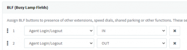

  1. In the Management Console >> Extensions >> <The extension you want to use> >> BLF >> Add the BLFs you'd like:
