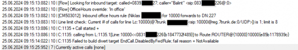

And the log is showing the following, with the error being the last entry:

Thanks! So are you saying the log entry is correct as it is? I thought the 2nd last line was an error?
Yes, log is OK, as there is no other forwarding and saying NotAvailable for the reason,
Failed to build divert target EndCall.DisabledByFwdRule; fail reason = NotAvailable
and then followed after
Inv[SentInvite&Neutral]} terminating with reason 'Not available', code = 480
