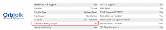

There may be a few factors that come into play but first thing to check is whether the SIP Provider allows it. Based on the info in our Supported SIP Provider's page the specific one does not:
The fact that there is no support for clip no screening means that you will not be allowed to show a caller id other than those registered under your SIP Trunk account.
