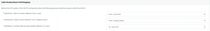

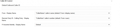

This is a generic SIP trunk. Both calls are routed through the same trunk, as there is only one configured. Please find the trunk configuration attached for reference. I have already updated the trunk settings as shown in the attached screenshot, but it had no positive effect.

Looking at your template there is no OriginatorCallerID configured anywhere so by default this will not work. If this was the same configuration as V18 then it would not work there either since the configuration to support sending the Originators caller ID is not present.
You will need to export the template, switch the correct SIP header (dependent on your provider) to "OriginatorCallerId" and import the template back into the system through Advanced-->Templates --> Provider Templates --> Import provider.
Make sure you delete the original trunk before doing so.

Thank you for your reply. I understand your explanation, however to double-check this I restored an old machine from backup and extracted the configuration where the functionality worked correctly. I compared it with the configuration on the current machine, and they are identical, which is why I am puzzled that it no longer works.
I have attached the configuration file and screenshots for your review. Could you please advise me on the best way forward? Perhaps the issue lies elsewhere.

Based on the configuration you have attached the scenario you are describing should not work in V18 either. The PBX either V18 or V20 needs the proper configuration to forward the originators caller ID back out and your trunk does not have it.
So either your call flow was different in V18 or something else is different.
This is the way to move forward. You need to adjust your template to use the originators caller ID in forwarding scenarios.
