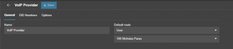

How is the DID assigned, and how is the provider sending the DID in?
If your DID is in the format of +12525551234 and the provider is sending it as 12525551234 then that would mean the PBX is not detecting it as a valid DID and is sending it to your trunks default route. What does that have assigned?
Check that this is not defined as End Call.
An easy way to check what is being sent by the provider is to do a capture on the call and see the format of the DID in the TO field of the INVITE coming in.
