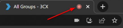

Oh and also notice whether this red indicator stays ON when the problem occurs:
This would indicate that the browser still thinks the Mic is still in use when it shouldn't be, confirming that the condition I replicated has happened.
Normally that should disappear after the call ends and the Mic is no longer in use.
