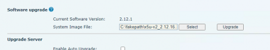

How do I manually update? There does not apear to be an option to do that. If I go to the phone URL, System -> Upgrade, and upload the file there, it does not upgrade the phone, it remains at 2.12.1
That is what I have tried. Upon selecting upgrade, eventually I get "The connection was reset", then after a refresh, it is still 2.12.1
