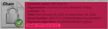

Lets double-check the certificates before anything:
  1. Go here
  2. Type your fqdn with its SSL port. Example: mycompany.3cx.com:5001
  3. Check the results, there should be only 2 certificates in the chain. NOT 3 certificates.
If you see 3 certificates and the bottom one is ISRG Root X1, with the below issuer, then you might have a problem
Let us know what you find.

Yes we are provisioning correctly - can access devices etc. We have 30 provisioned across all our branches the last batch of units don't provision.
I see Johns question is returning the problem certificate.
  1. Go here
Yes it is returning that certificate - do we need to remove it?

Hi John,
Yes, thank you it provisioned - much appreciated.
We manage a few other servers - is it likely we will have a similar issue? We only use the cordless at this particular site though.
Check the rest of your FQDNs in the SSL checker to see if you get the same result as we discussed before.
If so, you will need to manually renew certs.
https://www.3cx.com/docs/self-hosted-instances-ssh/
Do not renew certificates unnecessarily or repeatedly. Only in this specific instance that we found these conditions.
