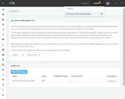

Hotfix for V16 and V18
This hotfix is only available for customers running 3CX V16 and V18. To install the hotfix:
- Click on “Updates” in the 3CX Management Console
- Select “3CX FQDN Let’s Encrypt Hotfix”
Alternatively, this will be triggered automatically when “Auto Update” is enabled.
