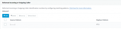

Make sure you have not setup https://www.3cx.com/docs/cid-reformatting/ , if so remove any settings - what is the number displayed now

Now i have no any settings here https://www.3cx.com/docs/cid-reformatting/

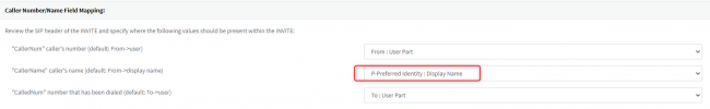

The PBX will present whatever is sent from the provider and whatever is configured in the inbound parameters of your trunk.
In your case you have it reading the Callers name from the "From:Display Name" header and the callers number from the "From:User Part". So I am guessing that the provider is sending the callers name and number to the From:Display Name" header and the number again in the "From:User Part".
So what you need to do is to tell the PBX to not read the "From:Display Name" header. To do so just set the value to a header that does not exist. Try the following setting and see if that leaves only the number displayed.
The reformat the number using the guidelines from this guide: https://www.3cx.com/docs/cid-reformatting/
You could try the following assuming that all incoming numbers are 10 digits long.
Hello @YiannisH_3CX
Thank you. It did help.

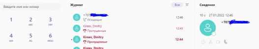

When Teams is receiving call it has caller id as I set in cid formatting:
079345678900
but when I call back it added +7 code and it looks like +7079345678900

is it possible to change teams to dispaly number in journal of outgoing calls in the correct format?
Maybe I need to change something in the dial plan for teams?
