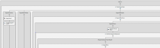

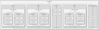

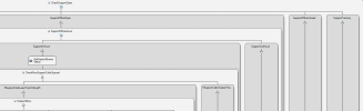

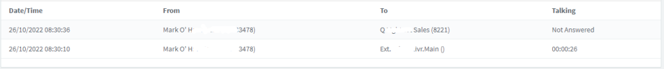

Hi @edossantos please see below the call flow for queue B, I have confirmed the first set of date & time conditions are working as intended, it is the date & time conditions in the CFD3 image that appear to be getting ignored. I have also included screenshots of the date & time condition settings for Options 1, 2 & 4 in the Support Menu (CFD3) and the call logs from a test call made at 08:30 this morning (selected queue B then option 2 and was transferred to Sales although the time condition should have transferred me to the Sales queue voicemail).
CFD1:
CFD2:
CFD3:
OpenHours:
ClosedHours:
CallLog:
What I need to analyze this is the contents of the 3CXCallFlow.log file, not the call log from the management console. But it will be also useful to see the full CFD project sources, so I can check a few things. Can you send me a private message with this? Start a conversation with me, upload the CFD Project sources (not the build output), and the 3CXCallFlow.log file in verbose mode once you reproduce the issue, and send me a link to download those files (you can't attach files in a private conversation).
