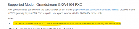

i am configuring with grandstream 4104 gateway on a remote 3cx PBX but auto provisioning does not work.
How can I configure it?
As @cobaltit said the device is not supported for remote provisioning. The provisioning link generated by the management console can only be used locally in the same LAN. You can create a site to site VPN and however so that the gateway is locally reachable by the PBX.

As a rule we do not recommend gateways for cloud hosted systems so we do not support any devices. We always recommend using a SIP Trunk and moving away from gateways to have a better user experience.
You can choose a supported SIP Trunk from our Supported providers list here: https://www.3cx.com/partners/sip-trunks/
Your path would be on-premise PBX if you can't get away from the POTS lines. Once you eliminate the need for a gateway by moving to SIP, then you can move the PBX to the cloud.
