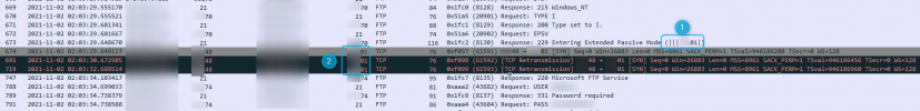

I've went ahead and taken a look at the packet capture and have found the following:
The FTP server enters Extended Passive mode and provides 3CX with a new port(1) on which 3CX must start a connection. The 3CX PBX initiates a connection to the specified port(2) but never receives a response:
Based on the above, you'll need to make sure that the port range the FTP uses for extended passive mode is accessible from the outside on the firewall(FTP end).
