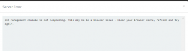

Hi I have gone through the setup and can't determine why the test times out.
ConnectWise
1. Create API Member with Admin security role.
2. Create API keys for member
3CX
1. Set the company name
2. Copy in the Public and Private key
3. Set domain to our on-premise url
4: Test - fail
Check the server and there are no issues. Flush cache, same result.
Would love some pointers here please.
Thanks
Andrew

So we're a little further along but this isn't very helpful at all. Is this on the CW or 3CX side? And where to even begin looking?
System.Exception: Server returned a non successful status code - HTTPStatusCode=InternalServerError - Reason=Internal Server Error - Content=The page cannot be displayed because an internal server error has occurred.
If the URL mentioned doesn't load and display something like this:
1626145405489.pngit's on the CW side and start with CW support.
Turns out there's an issue with CW.
Thanks for the assist.
An Internal Server Error is an error response returned by the CRM server. So the issue is on the CW side in this particular case.
